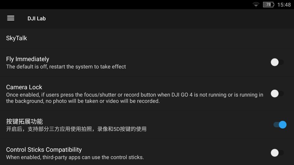

  3. [Smart Controller ONLY] For the record/shutter/5d buttons to work, enable the chinese setting in the Smart Controller Settings -> DJI Lab section. You may need to restart Litchi for the setting to be taken into account.
